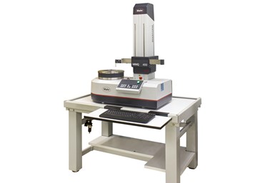

A vibration isolation table, like the one pictured here, may be required to eliminate errors due to vibration.

On the third floor, the vibration was amplified enough to actually feel it. Although the people down where the machines were couldn’t feel the vibrations, the machines certainly had the capability to measure them. I immediately ran down to the testing group with this information. We then did a surface finish measurement without moving the probe to check for vibration and there it was — a large, high-frequency vibration originating from a block and a half down the street. Now that we knew what the problem was, we could work around the construction schedule and conduct a successful runoff of the third machine.
Errors due to vibration are the insidious type. In most manufacturing facilities located in urban areas, there is a constant tremor which everyone gets acclimated to, and no one is apt to take notice as things vibrate and pulse. However, when trying to measure with precision instrumentation, a vibration-free environment is critical. Fortunately for many gaging applications, vibration may not play much of a factor because of their dimensionally large tolerances. But with today’s tighter tolerances, vibration is something that requires knowing about, monitoring and potentially taking steps to mediate.
When measurements don’t repeat, or there are unusual readings coming from a surface or form measuring system, it’s time to look to the environment and vibration as the potential source of the unusual readings. Relocating the gaging equipment further away from the source, or to a location that has a better foundation, may be the first step. Sometimes vibration pads under the gage will also help eliminate some of the problem. Mass often helps with vibration, so placing the gage on a large steel or granite plate can be a solution. A vibration isolation table may also be required.
