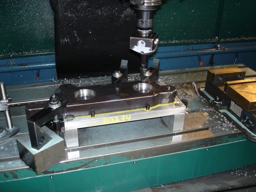

On a spinner plate, the combination of FeatureCAM and CNC mills reduced processing time from 4 hours to 1.5 hours compared to the previous method. On another part, the machining (drilling, tapping and milling) and two-piece assembly time went from 3 hours to 35 minutes. In addition, the fit between the two parts has improved.

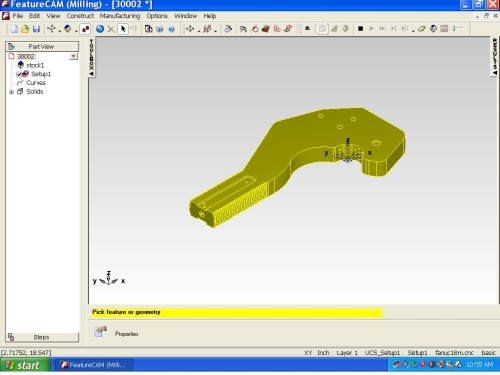

The new CAM package saves programming time as well as machining time at Hawk. Its feature-based programming makes it easy to create a CNC program for the company’s models. Most of the parts the company machines are held in custom fixtures, designed with FeatureCAM, to match the parts it must machine. This not only maintains consistency in setup, but also reduces setup time and allows the company to machine several parts in one setup.
With feature-based machining, the part is created using features that describe that part, from simple holes to complex pockets to turned grooves, and the operations are automatically generated.
Features are used as the building blocks to describe a complete part. They define shape, the faces of the part, the size and shape of pockets, slots, bosses, and grooves, the locations and types of holes, and whether those shapes have chamfered or rounded edges. Features can be revised rather easily by changing one or more individual parameters.
Part features not only describe shape, but also describe how to produce those shapes at the NC machine. They contain information describing how and where material removal should occur, cutting depths, whether to use climb cutting, whether to spot drill or center drill, and preferred machining strategies for roughing and finishing. When a part is constructed of features, the CNC programming process becomes automatic, the manufacturer says.
Hole features are commonly used, and Hawk says it makes a lot of holes for bolts, location and other purposes. First, the physical properties for the hole are defined, such as the hole diameter and depth, chamfer depth, counterbore diameter and depth, countersink diameter and angle, thread information and the coordinate location for each hole.
Then a drilling strategy is selected as well as whether to spot drill or perform a chip break. Based upon Mr. Russo’s choices, the software creates drilling operations. Defining holes in this way provides a single point of control as to how the hole is machined.
Once the operations are created, FeatureCAM selects tools based upon customizable rules. For example, if Mr. Russo specifies that a hole should be reamed, the program creates a drilling operation followed by a reaming operation. The drill chosen will be based upon a percentage of the final hole size, with the percentage being customizable.
Finally, once operations and tooling have been determined, the software recommends feeds and speeds. If Mr. Russo wants to change the recommendations for a specific application, he can override feeds and speeds as he creates the feature. Alternatively, he can edit the feed/speed database to adjust the feed/speed recommendations at the source, resulting in automatic recommendations that suit Hawk.
Mr. Russo can import a part design from SolidWorks into FeatureCAM and output a program in less than 10 minutes, including fixture design. Previously, it might have taken him 12 hours to program a SolidWorks model and additional time to try out the program. With the new program, Mr. Russo says he knows that the program will work without error or crashes. The manufacturing turnaround at Hawk seems to indicate that he is right.
