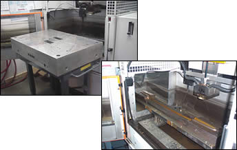

The modular fixturing system fromHirschmann Engineering USA (Buffalo Grove, Illinois) can be used on any of these machines. Its three main components are clamping unit, pallet and vise. The clamping unit secures to existing tapped holes located around the machine’s table. The vise jaws, which install in the pallet, clamp the workpiece from the side (in the case of a horizontal vise) or on top and bottom (vertical vise). A locking mechanism in the clamping unit secures the pallet/vise/workpiece on the table to a positioning accuracy and repeatability of 0.002 mm (0.00008 inch). One or more clamping units can be located at any point around the table. When clamped, the pallet extends the part into the center of the table, where the cutting heads have a better chance of reaching the entire workpiece.
Each new job that will use the pallet fixturing system starts at Extreme’s tooling setup station. A fixturing system clamping unit is installed on the station’s granite table (shown in the photo on page 84). During setup, a pallet with vise is locked into the clamping unit and the vise jaws are tightened to grip the workpiece.
The vertical vises use twin jaws that adjust independently to clamp workpieces of various heights. Because the two jaws install into the pallet separately, they can also secure parts that may have different thicknesses at the clamping points. Mr. Bernt has worked with Hirschmann over the years to develop taller vertical jaws to hold thicker workpieces. Current versions can secure parts as tall as 115 mm and are rated at 66-pound capacity (though Extreme has installed parts as heavy as 100 pounds). Mr. Bernt is currently testing jaws that can secure workpieces as tall as 160 mm.
The decision whether to grip the part horizontally or vertically largely depends on workpiece geometry, profile to be cut, amount of extra stock the mold maker provided for clamping and where the part must be indicated. Clamping the workpieces vertically sometimes allows better access to a pick-off corner when indicating a new job. Horizontal vises may interfere with the machine heads and prevent the wire from accessing that location. This can also affect how much cutting can be completed, as heads must stop short of the vise to avoid collision. In this case, two setups would be required to machine the part. There are similar instances in which vertical jaws could obscure a section of the workpiece that requires machining, so horizontal jaws might be a better choice.
